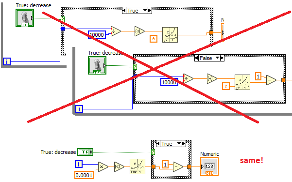

  • You cases differ by a single primitive ("x" vs. "1-x") All shared code belongs outside the case. No need to duplicate all that code.
  • Wiring a true constant to a "stop if true" termination condition will give you exactly one iteration. Shouldn't it run longer than that? ("run continuous" is a debugging tool, not a way to run a VI)
  • There is a primitive for "+1".
  • There is a primitive for e^x.

  • You still have lots of duplicate code in the cases, only the "1-x vs wire" should be inside the case structure!
  • You still have not found the exponential function.

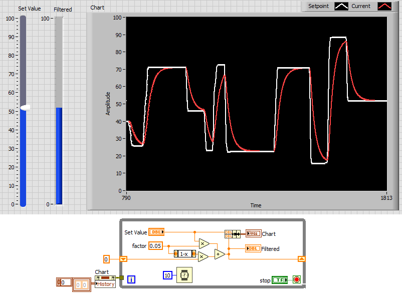

Maybe you are looking for something like an exponetial smoothing filter (wild guess). Her's a simple example (see also)

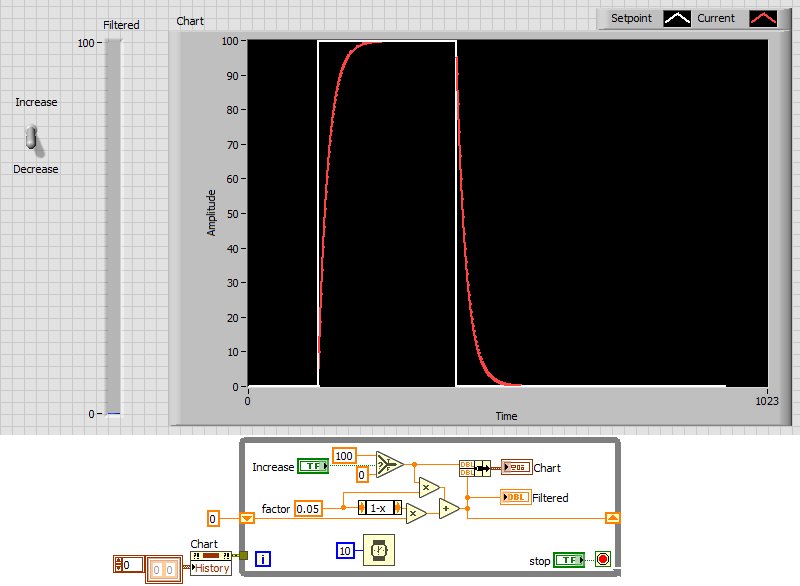

... and here's a possibility with just two states controlled by the boolean:
Note that an exponetial filter does NOT need an exponential function. An exponential is inherent to successive scaling operations. Think about it! 😄 It is left as exercise to the student how to convert from exponential time constant to the filter factor (0 ...1, fixed at 0.05 here)
