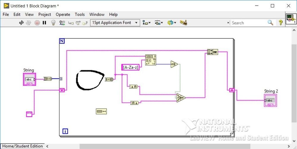

I am new in the LabView, and I have to do a task. When I will get lowercase it has to be display as a upercase and upercase to lowercase. File of vi - below. Any ideas how to fix it ?

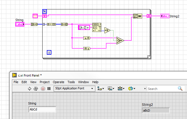

It's a little "Rube Goldberg" but it works...
The first change would be to change LabView to LabVIEW. 😄
For the problem at hand, I would keep it simple (assuming all non-alphabetical characters should remain as is):
(It is a little-known fact that many string functions work perfectly on U8 as we can see here. See if you can find the various other primitives :D)

I would like to do it, but it easy to have an idea, hard to do (just say). In my .vi, I just wanted to make it, but it's not working. Smiley Sad

That is in the Array palette and called "Build Array"
Converting the string to a Byte Array allows you to use the For Loop's auto indexing function to index one character at a time for processing.

@Matix02 wrote:
Where can I find this element ?
"built array" of height=1.
(Note that you did not copy the correct pattern so your code will not work anyway). 😮
Try to create and understand my code instead. Much more efficient! 🙂

Gee, I had no idea that the To Upper Case & To Lower Case functions worked on byte arrays.
Note that you can pull some of that stuff out of the loop (might make it faster):
Message 10 of 38
