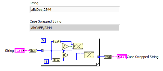

Nowhere in the problem statement did it say it had to properly handle non-alphabetic characters 🙂
Message 12 of 38
(3,162 Views)

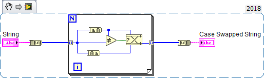

Paul, you never know what the compiler might do with all that, but your mod would in principle need to create allocations of several potentially very large arrays (2 exta U8, 2 Boolean!). Mine doesn't. 🙂

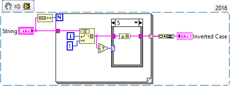

Several example solutions have been provided.
There is a function in the Comparison palette called "Lexical Class" that is often overlooked.
Here is an example that uses the Lexical Class function.
Welcome to the world of LabVIEW!

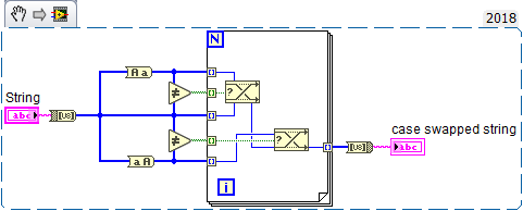

How's this?
Message 17 of 38
(3,108 Views)
@paul_cardinale wrote:
How's this?
You are still allocation at least twice as much memory (probably more).

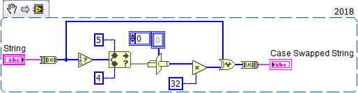

Also note that the entire left side could be replaced by a lexical class classification (4 or 5), which works on U8 (Of course the "class" is I16 (like your boolean to 0,1), so we are losing again 😉 I would still stick with a FOR loop for very large inputs. ;))
Message 18 of 38

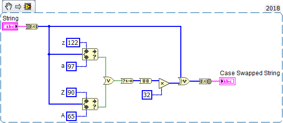

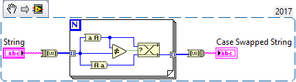

@altenbach wrote:
Any reason not to simplify further?
Message 19 of 38
(3,071 Views)

OK.  But I'm usually more concerned with speed that with size;
and this:
is about 30 times faster than this:
Message 20 of 38
