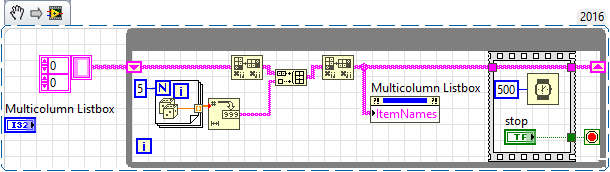

filling column by column
If Tetris has taught me anything, it's errors pile up and accomplishments disappear.
