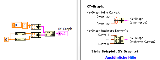

Hi Mayur,
see the context help for the XY graph to get an idea of what to do!
If you have problems following the context help you should attach your VI…

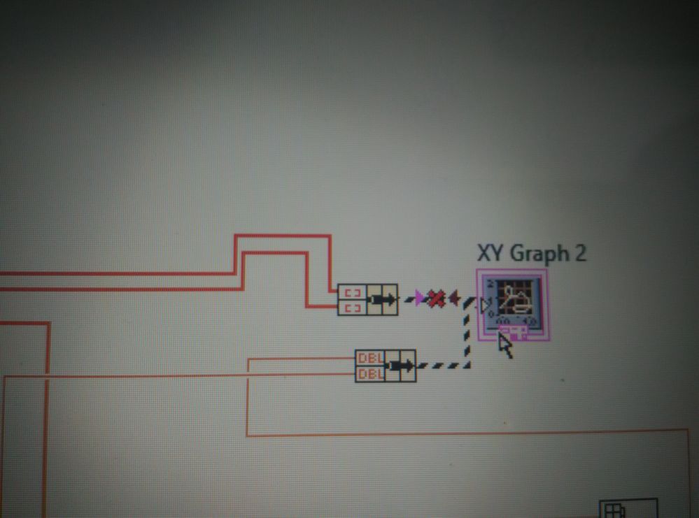

This is happening. Please send me some vi of you doing it.1505207806479..jpg

1. Your second plot will be really boring since it is a single data point.  Use Build Array to turn those into arrays before using the bundle.
2. Use Build Array to create an array of plots that then goes to the graph terminal.

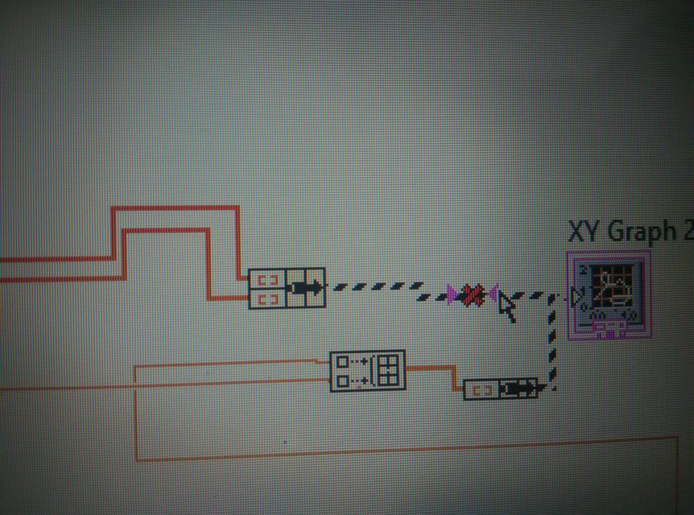

try this:
Exactly as is written in the context help: create a single plot by creating a cluster from two arrays, then create an array of plots…
When you don't understand the context help you should take the free online lessons for LabVIEW beginners! (I also recommend this training as you are trying to wire two data sources into one data sink: THINK DATAFLOW!)

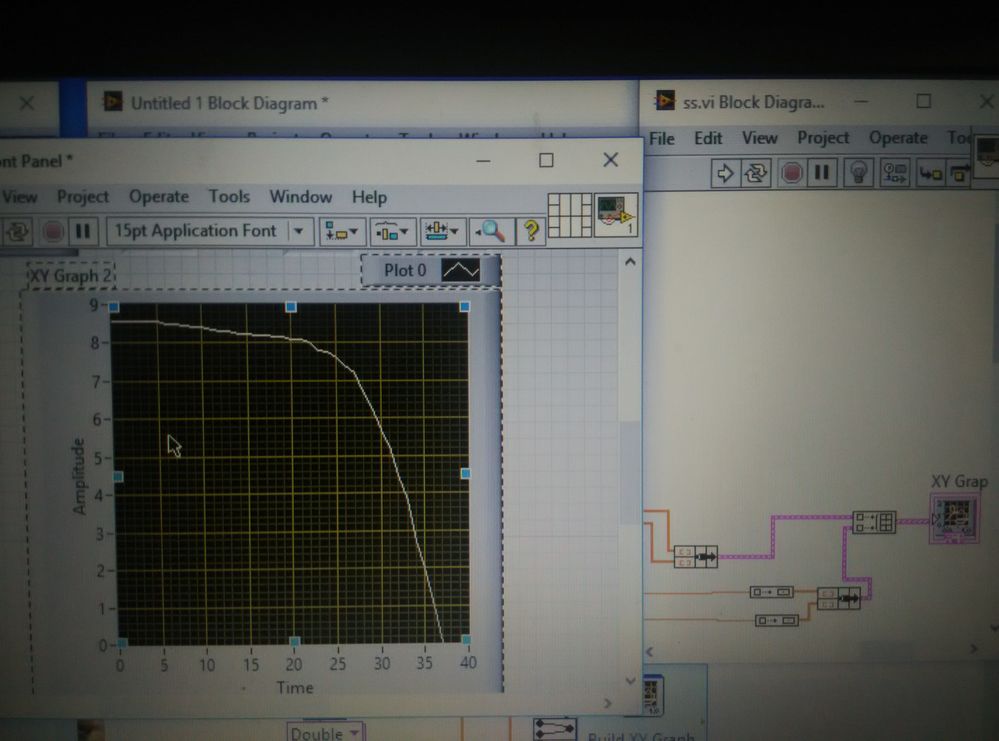

Accepted by topic author Mayur789
Hi Mayur,
change the plot style to show points…
(Hint: expand the plot legend to show two plots.)
