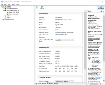

I'm unable to see or add a Serial port to NI Max. I'm running Labview 16.5 with Max 18.5.
The serial does not appear in Create new Port window. It immediately errors to NI Visa not installed or need to be reinstalled.
After installing NI-Visa 18.5 full I get the same error.

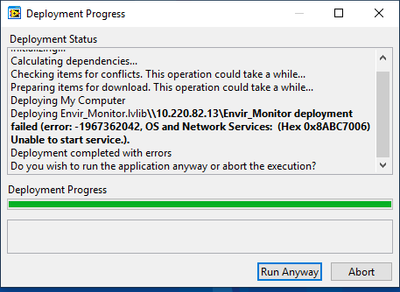

Here is the Services eror
Greg
Message 15 of 24
(1,059 Views)

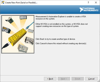

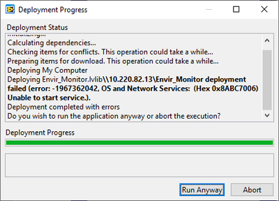

So I disabled Driver checking and reinstalled NI-VISA for the 4th time.
No difference, still get this error

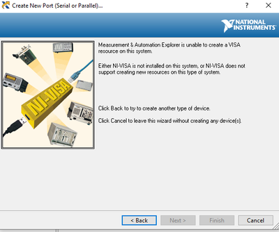

And when I try yo Create a new Serial port connection through NI-Max I get this error
However if I go into the Services.msc program and turn on NI Variable Engine all the errors disappear and it functions correctly.
So how can I make that happen automatically since it won't start through the normal Services at startup.
thanks
Greg
Message 17 of 24
(996 Views)

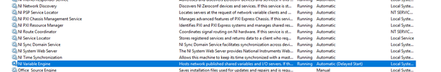

3.  You say if you enable NI Variable Engine the errors go away, but it won't start through normal services at startup.  Why not?  What does Services Manager say about that service when you start your PC?  Is it set to Manual instead of Automatic?  Can you give us a screen shot of the Services dialog?

1. this is the standard com built into a Dell 3060
2. Yes as I fixed each issue from the start of this thread I revealed a new one. I think I'm down to the last 2. It's been a good learning process.

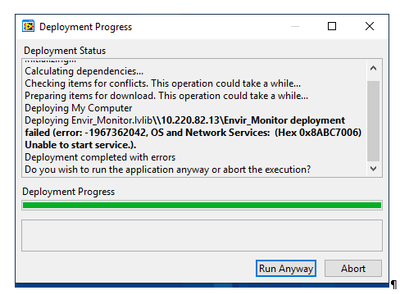

3. Yes NI variable error will not start. don't know why but this is the sequence of errors
At this point NI Variable is not running.
If I open NI-Max to create a new Com1 port as I need, I see this.
On entering Service.msc I can see that NI variable is not running. Starting it allows data to from from my COM1 port to my Labview program/display.
I will look into the software and try and determine why it won't start NI variable.

One more thing.
NI variable is set to Automatic start
Message 20 of 24
