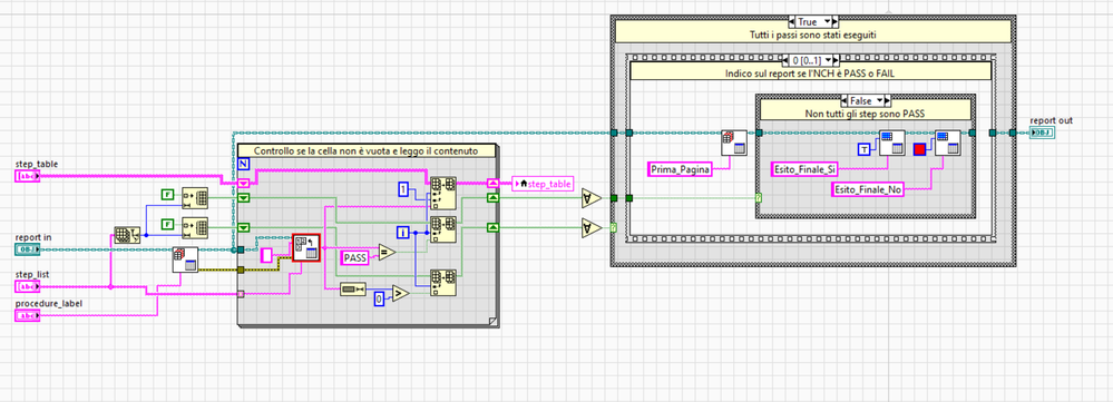

I'm having troubles updating a two columns table:
step table control is passed to this VI and updated within the for loop.
If I step trought the loop I can see values updated but as long as the loop terminate the resulting values are un-modified.
I'm missing something?
 Mike

I need to update the values of the control with the data updated within the for-loop.
Probably I have not understood how for loop and shift registers works but I just took a working code and changed the type of the input field.

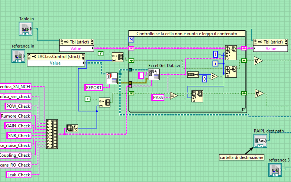

Given your suggestion I think I will have to move the table update inside the loop.
Anyway.. what I'm doing is trying to generalize a piece of code I inherited, this:
That was working...
(1,754 Views)
Accepted by topic author michele.santucci
I guess you want to update the table in the calling vi?
Then you need to pass it by reference - as in the example code - not by value.  If you pass only the value to the subvi, the original control will remain unchanged.
Alternatively, you may pass the new value back to the calling vi (via an indicator) and update the table.

I got this..
