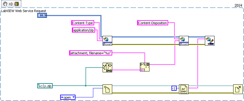

I have attached my solution how the server can send a file to the user. This part is working, but I need a file transfer to the opposite way as well.

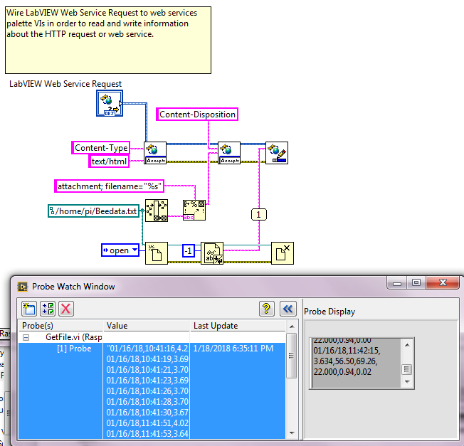

Hello all, I replicated the above VI.  I want the web service server to send a text file to the client.  The client side downloads the file but the file is empty.  Attached is the block diagram probing the text file showing there is data. Any help would be appreciated.

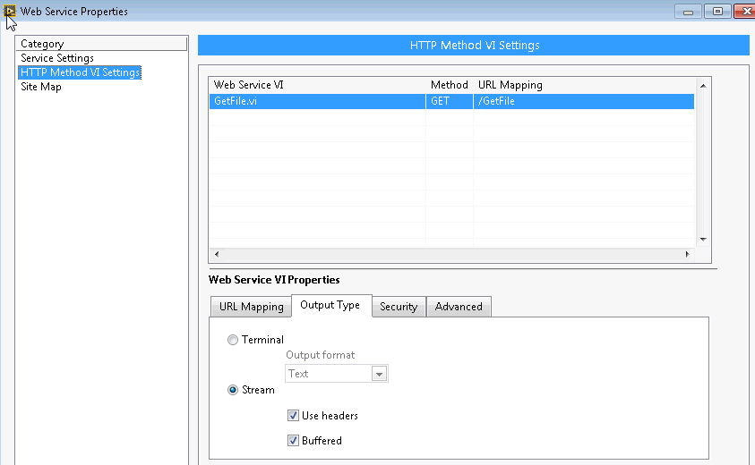

The problem is solved by going to web Service properties and changing the setting from Terminal to Stream.  See pic.Screen Shot 2018-01-18 at 7.57.51 PM.png
