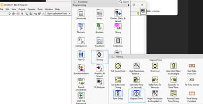

I have reviewed the topics you mentioned, thank you. I was wondering if you could recommend anything regarding elapsed time calculation? Kind regards.
Message 13 of 29
(1,047 Views)
There is a build in function for that:

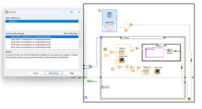

Hello again,
Yesterday, I tried to understand the structure you shared with me and modified it to better fit my homework. I’m currently working on completing the required timing functionality. For that, I used the Elapsed Time block, but after making such a change, I started getting some errors. I’m trying to complete my assignment quickly, but I’m having a hard time fully understanding and resolving the structures I see online. However, with the feedback I receive from this forum, I’ve been able to make progress. Thank you all for your help.
In this step, I’m trying to make the program automatically stop if it runs continuously for 60 seconds.

The changes of the time being exactly 60 secs is miniscule. Change to Equal or greater comparison. You can't wire 2 booleans directly to the Stop button, they need to go through a logical gate, i assume an OR.

Hello again,
I have carefully reviewed the guidance you previously provided. I’ve also explored relevant forum topics, studied various resources, and watched several YouTube videos to better understand the subject. I’ve now reached the final step of my assignment.
In this step, I’m trying to implement a system where, once the Start button is pressed, the program counts 60 seconds. If the program runs continuously for 60 seconds without pressing the Stop button, it should automatically terminate. I tried designing a system that measures the elapsed time accordingly, but I encountered issues such as missing tunnel errors and red "X" indicators.
