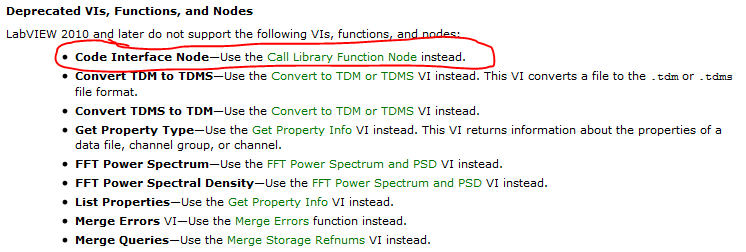

The code interface node was indeed deprecated after 2010.
Cory K

Thanks for pointing that out. So how can I use a C file in LabVIEW?
Message 5 of 8
(5,749 Views)
You can't. You can call a .dll.  The "formula node" has some "C like" syntax for calculations and logic, but those are your options.

Thanks. Probably I need to compile it to a dll before using it. 🙂

Not just probably! Smiley Very Happy It's the most straigtforth and simple possibility.
