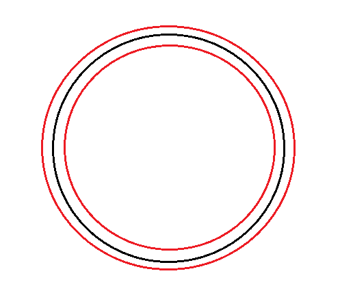

As for the problems, I think maybe boundaries can be set in the program. As shown in the figure, the black circle is the target trajectory, while the red circles are the boundaries. If the cursor enter the region between the two red circles, the mouse trajectory will be displayed. If the cursor is out of the region, the path should not be demonstrated. Then the problems with the first points can be solved. Is this ok? The problem is that I do not know how to set these boundaries in the program, so could you teach me with that? And I do not know what do you mean by the circle is not actually drawn where the pointer is.  Thank you very mush for your kind help!Smiley Happy

More comments:
  1. You should always think about the data. You have your array of points in the shift register. You can just take that out of the loop and use that as the input for the processing loop.
  2. It seemed as if you want to analyze the user's performance. To do that, you need to let them perform, not limit them while they're trying to work. If you want to filter bad data, I would suggest a mouse down on the picture to trigger the acquisition and another one to finish it. For the moment, you can use a local variable and set it in the event loop.
  3. In that same direction, if you want a certain piece of code not to execute, you need a conditional block. In LV, that's done with a case structure.
  4. You don't need two separate stops. Just use the one stop to stop both loops.
  5. If you want to compare and analyze something, the Comparison palette has some relevant functions. I would suggest looking at the In Range & Coerce function. You can use that to check that the radius is in the accepted range.
