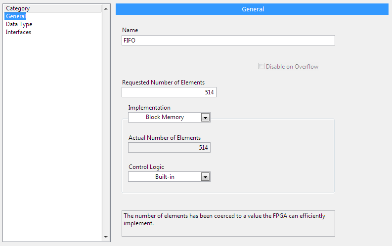

You can define a target-scoped FIFO using "in-built" FIFO functionality using BRAM.  I use this in our current software to bridge different processing areas running at different speeds.  You need to make sure that you're using the built-in FIFO functionality that the FPGA card offers, then it works fine (we also use a 7965R).
This is assuming that the BRAM implementation can keep up with your 250MHz rates, but at least the different clock rates of producer and consumer are no longer a problem.  I don't think the DRAM interface is going to cut the mustard since it's limited to 200MHz (Max) and is not really deterministic.
Having said that, depending on the width of the data you need to buffer, this might also not work since you only have 8MBit available.  If your data is less than 18bit, you may need to do some bit-packing to get your data to fit, if it can fit at all.  200k Samples divided over 8MBit only allows for (assuming 200k samples) maximum 40-bit values to be buffered but then you're using ALL of the block RAM on your device which will most likely also lead to timing errors as the routing will be horrendous, especially at 250MHz.

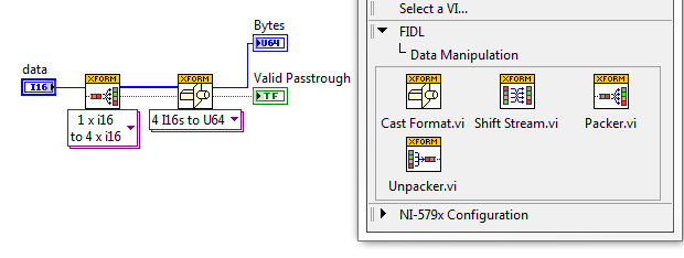

Also, what version of LabVIEW are you using? There may be some libraries I can point you to that assist with things like packing data. For example, the FlexRIO Instrument Development Library has a data manipulation library you may be interested in.
