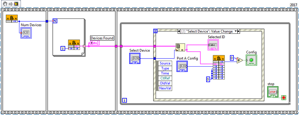

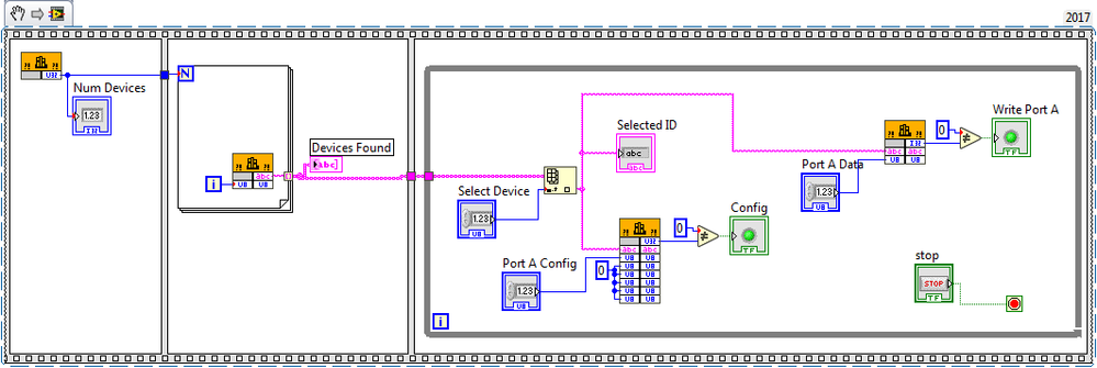

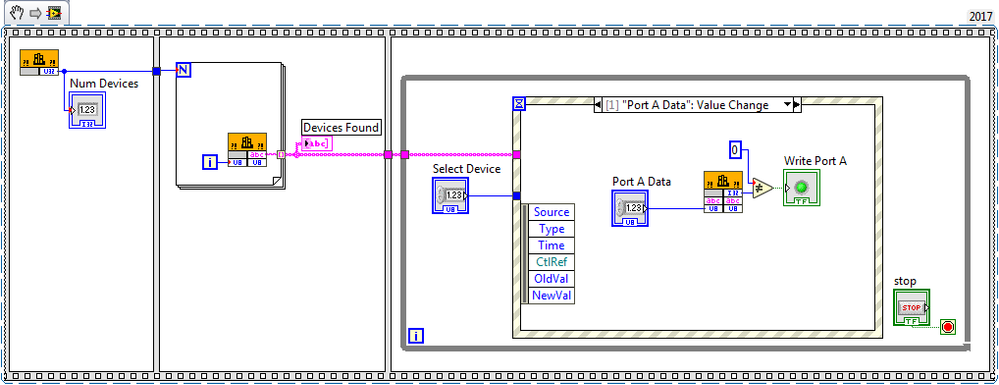

Place the device ID (string) on a shift register. Place the Port A Config inside the Port A Config:Value Change event. Typically you want the control inside the Value Change event, because otherwise the value will be old (so move the Device control (numeric) inside the Event Structure for the "Select Device:Value Change" event). Take the output of the Shift Register as the input for the two library calls.
Edit: I added an example VI saved with 2017. I didn't add snippets because I didn't want to add one per case, but it looks like the printed output will be the same. I've placed them as images below. Apologies about the spacing, which may be better or worse on different devices.
exampleEventStructured.jpgexampleEventStructured1.jpgexampleEventStructured2.jpgexampleEventStructurep.jpg

Thanks for putting so much work into this! I'm still trying to figure out how it works. I see that you've put an Index Array into two places--outside the While Loop and inside one event, and they're both "controlled" by two items called Select Device. One of them is a classic control, inside the Event case, and I can't figure out what the other one (outside the While loop) is.
If I double click either one of them, it highlights the same control.

The control outside of the loop is a Local Variable. It can be used to either read or write the value of an existing Control or Indicator. However, you should be careful when using them because they can lead to poor programming and race conditions. When you double click, it demonstrates that they both refer to the same control.
In this case, it's used to allow me to place the terminal inside the event structure, to make sure it's read properly (i.e., after the value change and not before), but still know what the value is when the VI starts (which is when the local variable will be read).
The Index Array outside of the While Loop sets the initial, starting value of the Shift Register.
If you don't have an initial value connected to the outside of the left side shift register (i.e. where the output of the Index Array, outside of the loop is connected) then the starting value will be whatever it was the last time the VI ran. It reverts to the default only when you allow the VI to leave memory. More detail can be found here.
If you don't place that in that location, then it would be possible that you had a different value on the Shift Register when you started to what was the value of the Control, which probably isn't what you want.

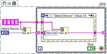

You DON'T NEED and shouldn't use a Local Variable.  You just need to think where you need what.  Here's the same Event Loop, with the "real" variable being used outside the Loop to initialize things, and when its value is changed, the Event Structure has the "New Value" as part of its structure, so you use that.  Like this ...
No Race Conditions, no wondering "Where did that come from", no finger-waggling from People Who Know Better (I'm not counting myself, of course) ...
Bob Schor
