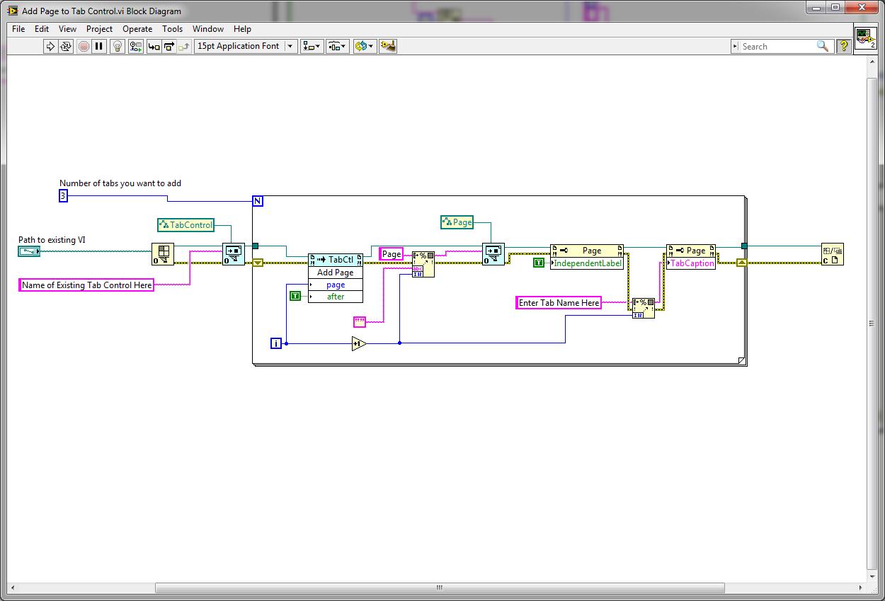

Can you kinldy add an example that shows how you created /added additional pages?
