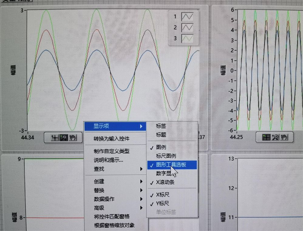

I want to adjust the X-axis range through the slider during the operation of the waveform chart to realize the scaling of the waveform on the X-axis, so as to see some details. Is this feasible?  I tried to adjust the increment of the X-axis in a while loop in the test vi I uploaded , but it didn't seem to work.

You can right-click on the waveform chart on the front panel to bring up the graphics tool selection board using the tool to adjust the X-axis range online!
(981 Views)
Remember to turn off the auto-adjust X-axis scale!
