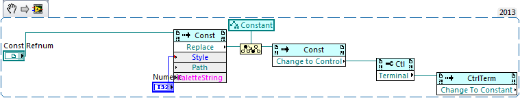

check this out. I was out of it for a couple of minutes when I discovered this was possible...
https://decibel.ni.com/content/docs/DOC-40984

Pretty neat, I'll have to check that out when I am on my computer with LabVIEW but it seems that this is only possible to achieve with scripting correct?  I'll check tomorrow to see if there is an ini token for it.

To revert to normal constants, change to control/indicator and back to constant again, whether manually or with scripting. The Snippet shows an addition to the right of the ReplaceMethod in the originally posted VI that does this forward-backward change.
