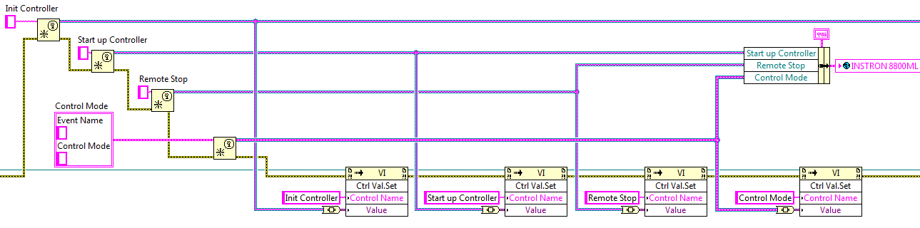

1. In main application User Events are obtained and send to external app to appropriate control. References are stored in global variable

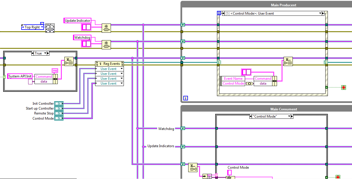

2. Start external app in which User Events are register:

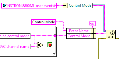

3. In Main application Event User named "Control Mode" is generated based on reference read from global variable:
Unfortunatelly I am getting the error number 1

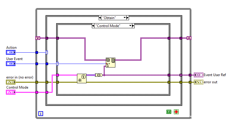

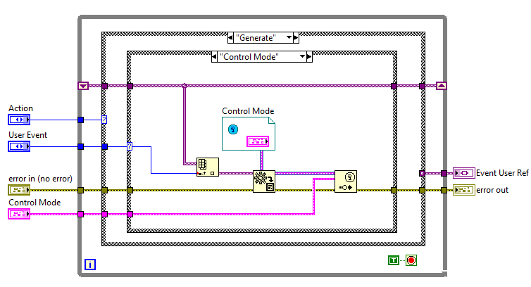

I tried also FVG with Obtain function and Generate Event inside. It does not help.
See pictures below:
Notice please, on picture above casting from variant to User Event reference is giving already error 91. I mention that in previous post.
User reference constant has been created from the output of Obtain function.
User reference constant should be same type as references created from Obtain function, however constant contains zero value whlist reference created each time, some number.
Can it be that LabVIEW treats those two references (constant and newly created) as a different type?

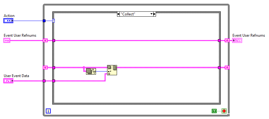

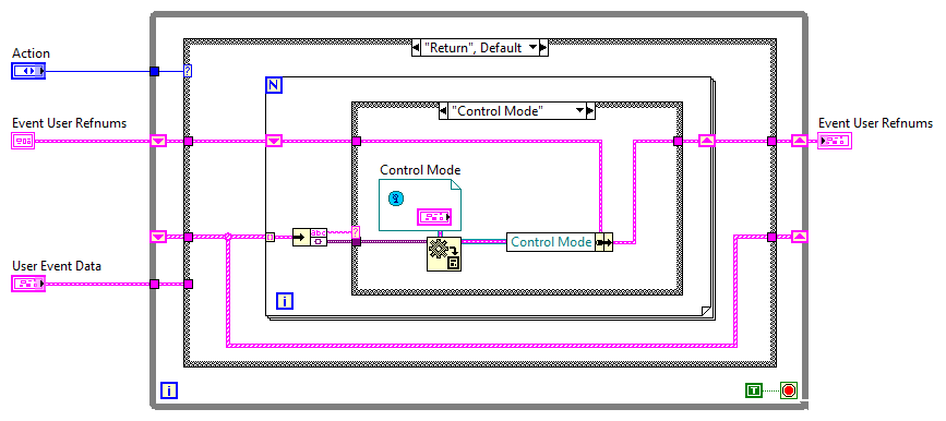

Another FGV that I tried to use to pass User Event references is typical:
At the moment I don't see any better solution like creating additional booleans in external app. sending the data to them from Main app. and use of value signaling property to make external app. reactive.
I appraciate any suggestion.
