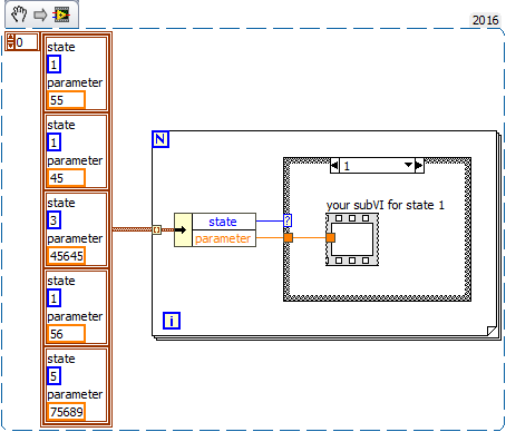

simple example for ideas
(3,395 Views)

I finally have time to continue my Project. And another Problem occured. Artem suggested to use an Array of Clusters. This technically works. I use an enum to choose the state and multiple nummeric controls/Combo boxes and string controls to deliver the parameters. The Problem is that each Array consists of the same items but with different parameters. Some states only need 1 parameter and others 5. Because of that my guess is that an Array of clusters might be the wrong approach.
What I wish to happen is that if the user chooses the first function the right controls appear for that function. When he chooses the second function the Right controls for that function appear and that could be controls of differnt types and/or a different amount.
