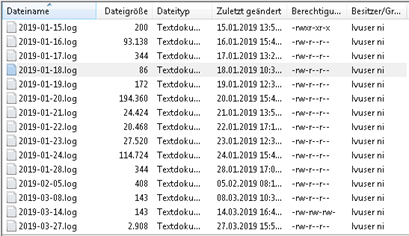

I am currently facing some serious issues with file permissions on a RT-Linux cRIO. It seems as if the same code would randomly change permissions:
grafik.pngIt might also be the case, that some files were created by different builds or from debugging mode.

The files all have read/write permission for lvuser, which is the account the real-time application runs under, so that shouldn't be a problem. I'm unsure why some files have extra permissions set. Were they all created with the LabVIEW RT app (and not created with a text editor or copied to the cRIO)?
What options are you supplying to the Open/Create/Replace File VI? Is this the only place the log file is created and written to?

Your're right, we found a document related to RT security (http://www.ni.com/pdf/support/us/ni_linux_real-time_security_user_guide.pdf / Page 26), which states that the LV application runs on lvuser, so write access should go to /home/lvuser. It seems that it works, if we use this location as a location for log files. But the strange thing is that it did work sometimes. Actually we have one system running for months now.
