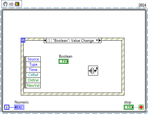

In general, it is a Good Idea to have an Error Line running through the lower corners of your sub-VIs, as is the case with most LabVIEW Functions on the Functions Palettes.  This being the case, enforcing a Serial order by putting VIs serially on the Error Line is (to my eye) more visually appealing (and much more compact) than placing them in big, clunky, surrounding Flat Sequences.  The only time I use a Flat Sequence is when I need to "order" a Function (such as a Timer) that does not have an Error line -- I often place it on/near the Error Line where it would go if it did have an Error Line Running Through It (there was a recent movie with a that title, or something close, recently) and surround it with a Flat Sequence Frame, tunnelling the Error Line through the Frame.
As for Mechanical Actions, the Latches (particular Latch when Released) lets the Boolean Control be "momentary" (it "pops up" when it is read so you don't have to "turn it off").  It is most commonly used in conjunction with the Event Structure's Value Change Event, with the Control being placed inside its Event case.  Being in an Event Structure means that as soon as the Control is Released, its value changes, the Event "fires", the Control is read, and it "unsets" itself, all in microseconds without you needing to even think about it.

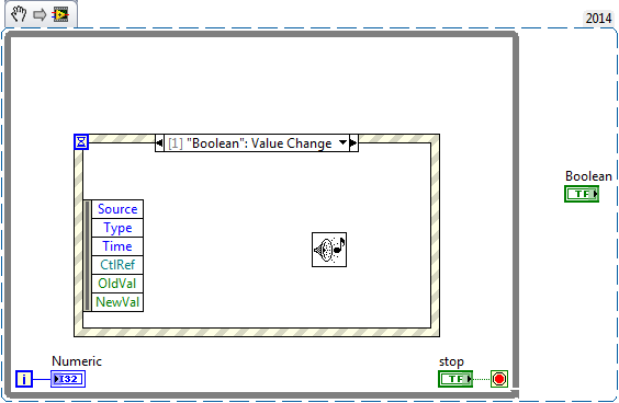

Bob: the first one correct, the second one wrong. But i both examples the numeric only increment with 1. If I understand you correct it should increment with 2 in last example because the event fires to times because the botton is not reset. Or ?
Bob :control outside loop.pngcontrol outside loop.png
