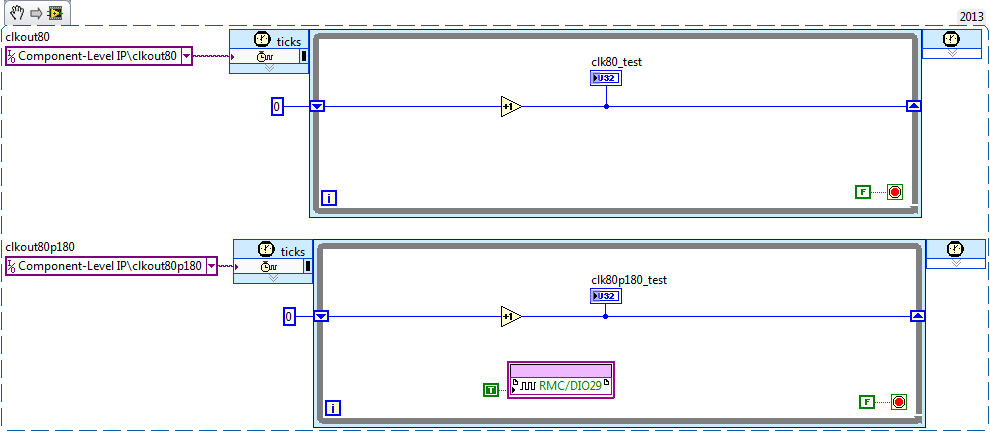

The VHDL itself seems ok and using Component-level IP wizard i can add this CLIP into project. ClkOut80 and ClkOut80P180 appears in a project. The simple BD is below:

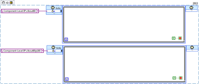

Do you need a constraint file? I was able to compile a VI with your block diagram without the constraint file and the CLIP defined clocks.
See the following .zip file.
Scham
(3,721 Views)

Why I've posted a question. Initially I created this test code for a CLIP:
And it failed to compile with an error: "LabVIEW FPGA:  The compilation failed due to timing violations, but there is no path information because the timing violations are not of type PERIOD." Compilation log in attach. Then I decided to play with additional constraints file in order to remove an error.

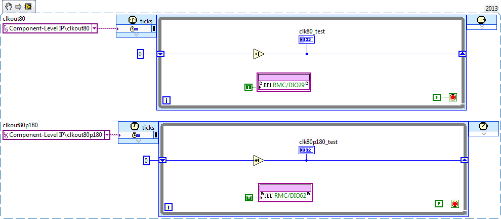

After your post I tested this (working):

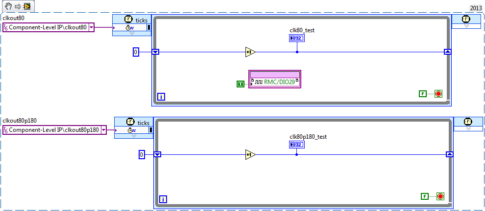

And this (not working and returns the same error, note that without DIO node it compiles and works):
