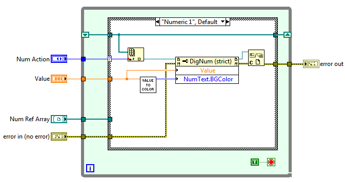

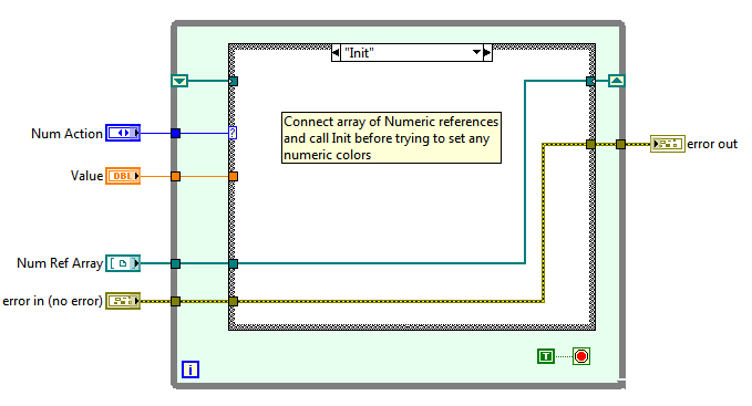

Hi Cassidee,
I sugest using Altenbach's method with an Action Engine. The Action Engine can be used wherever it's needed.
Attached is an example in LV2010 with code to test it included.
The action engine is called Numeric AE.vi and contains just two states:
Note that "Num Action" is type defed and the "Init" entry is the last one so we can easily index the correct reference.
steve
Founding (and only) member of AUITA - the Anti UI Thread Association.
