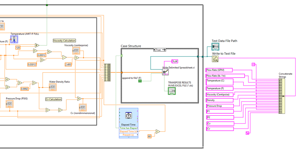

Question 3 (separate): I am trying to have the data be recorded to the excel sheet automatically every 15 minutes for (5 seconds or so? trying to get 500 data points roughly). Is the setup I used for the timing module correct? If so how would I correct it so the module will record data points every fifteen minutes over a 5 hour span per say?

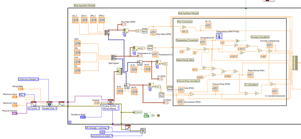

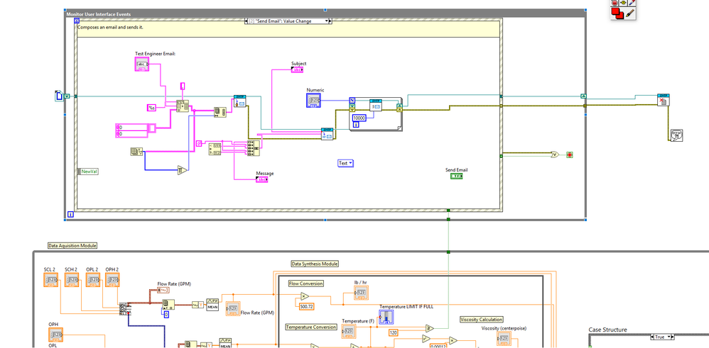

Here is some photos of the .VI for anyone who can help with my initial questions. Again, I am trying to connect the expression comparison with the email send function, along with trying to figure out the timming issue. I appreciate the concern of some of you, but I am not looking for a lecture on safety or software development (not even my field) I just need some clarification on the LabVIEW stuff. Thanks for your time and patience!
While you don't seem to enjoy unsolicited advice, I'll try again looking at these three things individually.
You don't understand your situation well enough for your initial questions to have meaning.  This is why you're getting the advice you don't like.  If you asked someone what the best way to push your car across the street is, would you want them to answer that explicit question or would you prefer they point out you can start it up and get it across easier?  The question you're asking is a bad question and it leads to more bad questions (does this happen once or continuously).  This isn't meant to be insulting or lecturing.  It's pointing out you need to take a step back.  One of the most important things you can learn in engineering is when it's alright to step back, re-evaluate a solution, and look at alternative options.  This is one of those times.
No, you're not.  You're trying to find a solution to deal with the problem you have when the test loop overheats.  You've decided the best way to go about this is to send an email.  You're not specifically trying to send the email.  You're trying to address the overheating.  Do not confuse the two.  The answers you're getting are in relation to the problem, not your posed solution.  They're directly addressing the problem you've posed and answer the question you're trying to answer.  They do not address the poorly designed solution because it's better to help you find an actual solution rather than a flimsy bandaid falling off the moment it's applied.
Again, you're mistaken.  If you're working on this, it is quite literally your field.  It may not be what you ideally wanted as a profession.  It may not be what you studied.  But, you're making software design decisions in the interest of the safety of employees, equipment, or both.  You ARE in the software design field.  You ARE in the safety field.  You DO need a lecture if you're oblivious to both of these.  You DO need to make better decisions as a software engineer as that is the exact role you're currently working in.  While you may have other components of your job, this is one of them.  You can't hide from it by saying "I didn't study this!"  Simply put, you need to find a better solution than the one you've posed.  You've been given ideas here.  Your best bet is to have the test safely shut down in the event of an overheat, not email someone hoping they'll see it in a timely fashion, quickly respond, and quickly shut down the system.  That ignores common sense at every stop.  If you're going to use that as a solution, you're honestly better off just leaving it be.  It works.  Users can see the test overheating.  That's one less step, at least, than seeing the email and getting to the test.  Here, they only need to see the test.
Take that time.  Step back.  Re-evaluate.  Apply some common sense to your solution.  You, and your company, will appreciate the results.
