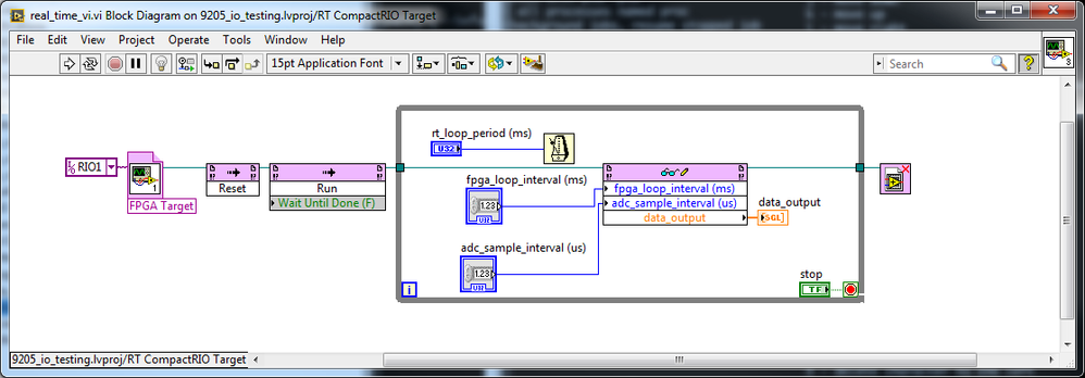

Here's a screenshot of the FPGA code:
Here's the real-time code:
Here's the results on the front panel:

Looking at the results, it's clearly returning the data from channel 31 in between channels 0 and 1, but channel 1 does not look like the cap has been drained.  Am I really controlling the order in which the channels are mux'ed to the ADC, or am I just controlling the order in which the data is returned to me?  In other words, does the mux always go from channel 0 to 31 in order, no matter what I request?  If so, why does the article linked above explicitly tell me that I can control numerical order?
