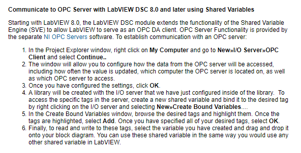

    I am communicating using shared variable method as described in the link you sent me.

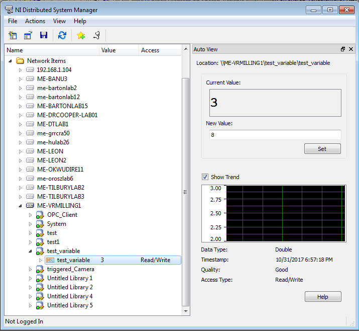

Do you have another computer with NI Software installed on the network? I'd like to verify that the shared variables are being published on the network - essentially, I'd like to validate that we can read/write to the shared variables on an any system (other than the host) before we figure out why the camera can't talk to them.
If you do have another computer on the network with NI software, launch the Distributed System Manager, and find the host computer. Under the computer, do you see the shared library, and the OPC tags that you have created? Are the values updating, and can you successfully update them?

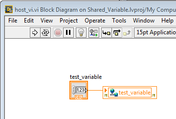

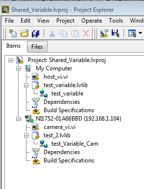

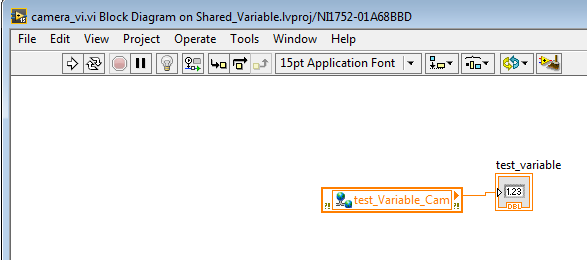

     Thanks for the reply.  I have checked the NI distributed system manager.  The shared variables on the host computer vi are being reflected there and I am able to update them. But a shared variable, that I created under the Camera and bound to the OPC tag shared variable, is not being shown there.  I tried with a simple floating value, without any OPC.  Even so, the shared variable under the camera is not shown in the distributed system manager.  I have attached the vi I used for testing.
AS you can see from the above images, the shared variable 'test_variable' on the host computer, is being shown on the distributed manager but the shared variable 'test_Variable_Cam' bound to test_variable is not shown.

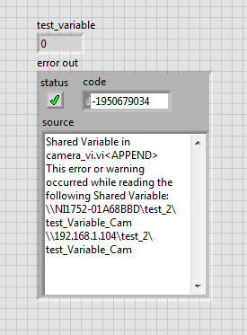

Also,   I get the following error which I believe is some firewall issue.  I dont know how to solve this.  Would really

Hi Gibin,
In order to see the shared variables from your camera, I believe you should be looking under the IP address of the camera in the NI Distributed System Manager. If you try expanding the first element of the tree, do you see the shared variable there?
