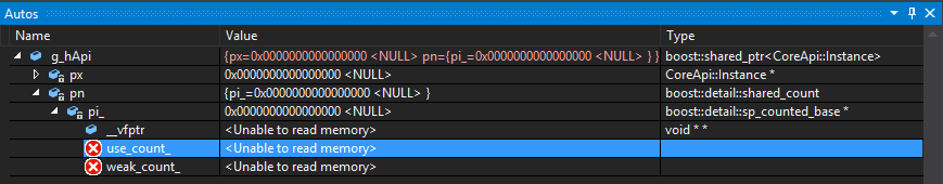

This program still runs, which I then select the VI to use the .net constructor node-> invoke node -> close ref node, then it proceeds to run through the wrapper code. However I receive  the following output from debug variables in VS.Null pointer in VSNull pointer in VSThis will cause the rest of the code to fail since g_hApi is a shared pointer (handle) to the native c++ class, and my catch block in enacted which returns a 3 to LabVIEW. An example of my code can be found on stack overflow at :

If that SDK is really written in C++, rather than C# and using .Net, I don't think it is a good idea to try to interface this to LabVIEW as a .Net assembly. You may have more success by creating instead an old style (unmanaged) DLL that exports your functions and interfaces to LabVIEW through the Call Library Node.
Obviously it would seem that your first call Instance::initialize() already fails for some reasons. There might be a myriad of reasons for this but most likely somehow somewhere your SDK API that you are calling somehow doesn't get auto initialized properly or it can't find specific dependencies that it might or might not try to located dynamically. In either case the problem at that point is not the code in your wrapper but something you might have forgotten to call first (despite the note that this function call needs to be the first to call from this API), or the way the DLL and its possible dependent DLLs are located, or a clash with the C runtime initialization from your wrapper and the SDK API. By eliminating .Net from the equation you at least avoid one extra monster in the cage that could try to fight the other monsters (a C++ library containing the boost library can be an ugly beast to tame when trying to interface it to non-boost environments).
