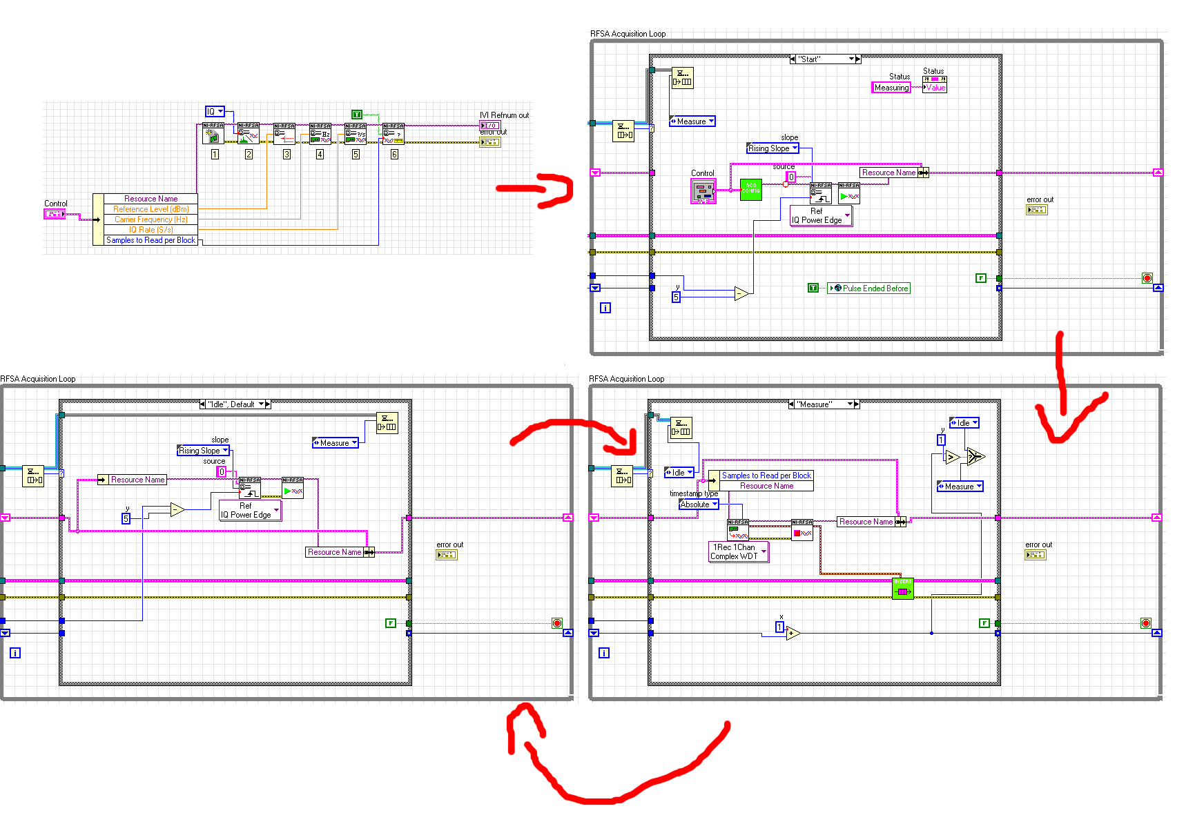

This is done in a while loop. The problem is that the trigger activates the fetching only at first iteration. If I want to fetch again I have to use the abort VI to stop the acquisition. Then the configure trigger again and initialize again. It looks something like this:
  Please elnight me, couse I feel that I'm missing something very basic here 🙂
