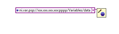

I tired using the method as shown below but i failed to get data from it. xxx.xxx.xxx.xxx is my external IP and pppp is the enabled port. I not sure whether i do it in the wrong way. Pehaps the shared variable is not supported for external network data transfer.

Perhaps it is a port forwarding issue? If the device you are trying to communicate with is behind a NAT router/gateway then it will need to be configured (along with any firewalls) to allow communications on the port that you've specified.

This document should direct you to what ports you need to open:
What Ports Do I Need to Open on My Firewall for National Instruments Software Products? https://knowledge.ni.com/KnowledgeArticleDetails?id=kA00Z000000kH68SAE&l=en-US
