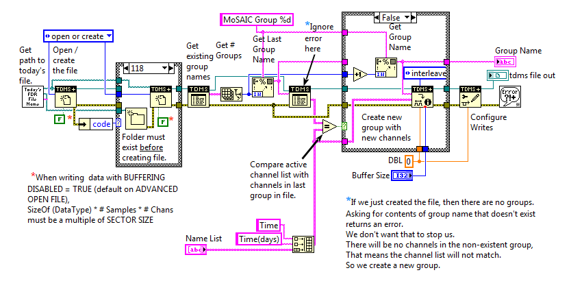

Here's the OPEN FILE code.  Again, with the exception of how the NAME LIST comes to be, this is a copy of working code on Windows desktop.

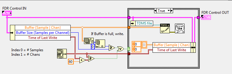

Here is the code that actually writes the data.  Nothing fancy, just see if the buffer is full and write it out if so.

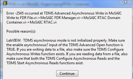

The trouble is, I get an error -2545 at the WRITE function:
It says to "make sure the enable asynchronous? input of the TDMS Advanced Open function is TRUE".
Well, the default value is listed as TRUE, and I'm not wiring it.  I tried wiring a TRUE to it with no change.

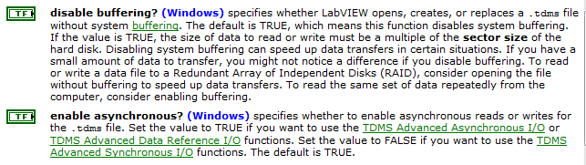

But it also qualified the HELP text with a "(WIndows)" qualifier.  What if you use it elswhere?  The HELP doesn't bother to say.
It says to "make sure the TDMS Configure Aysnchronous Writes function exists".  By "exists", I assume it means "is called", but that it is in the OPEN procedure above.
The help here is also qualified with a "(Windows)" qualifier. What if you use it elswhere?  The HELP doesn't bother to say.
Did I miss something that says "you can't use TDMS on non-WIndows platforms", or you have to set the "don't-be-stupid" property to TRUE, or something?
EDIT:  Here is the help text:

(windows) suffix means that these modes are only supported on windows platform.
In your case, TDMS doesn't suppport asynchronous or buffering disabled I/O on RT. If you don't care about high performance, I suggest you using TDMS standard functions on RT.
