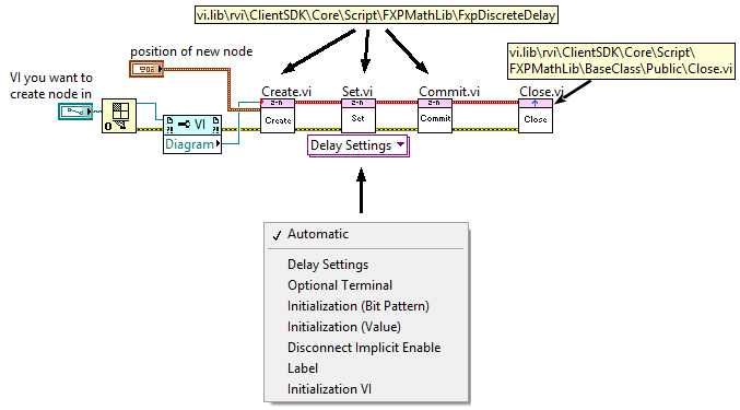

There is an unofficial API for scripting FPGA nodes here:
[LabVIEW 20xx]\vi.lib\rvi\ClientSDK\Core\Script
Here is what the scripting diagram would look like for creating and configuring the Discrete Delay node:
National Instruments does not support using this API, but it should be relatively straightforward to figure out. Good luck!

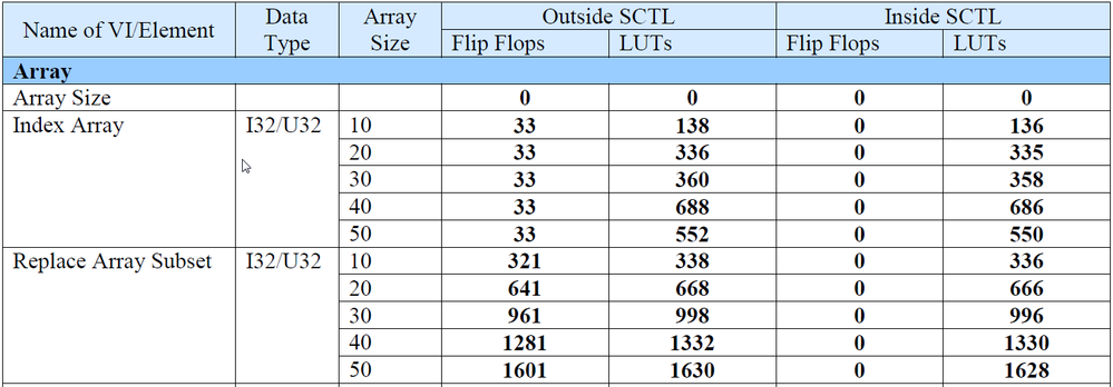

The thing with Arrays is they take not only space for the array itself, but rotating and so on take increasingly more resources the larger the array gets (i.e. the number of elements in the array as well as the size of each element).  BRAM resource usage stays pretty much constant irrespective of the length of the buffer (unless you need more than 1 BRAM). Indexing is "free" because it's dedicated hardware on the FPGA chip.
My cut-off is normally around 200-300 LUTs or Registers. Then I'll implement something in BRAM (Our design has plenty left over).
Here's an excerpt from a really old document outlining how expensive different operations actually are in LV FPGA. It was back in LV 8.5, but the basic scaling I think remains accurate, even if the numbers are not all 100% correct. Of course, this is for dynamic addressing, not valid when the same indices are always being read (as would probably be the case here). Static indexing is way more efficient.
Note: These costs are for the advertised operation only, they do NOT include the cost of the actual array storage itself.
Increasing cost of array size (Dynamic addressing only)Increasing cost of array size (Dynamic addressing only)

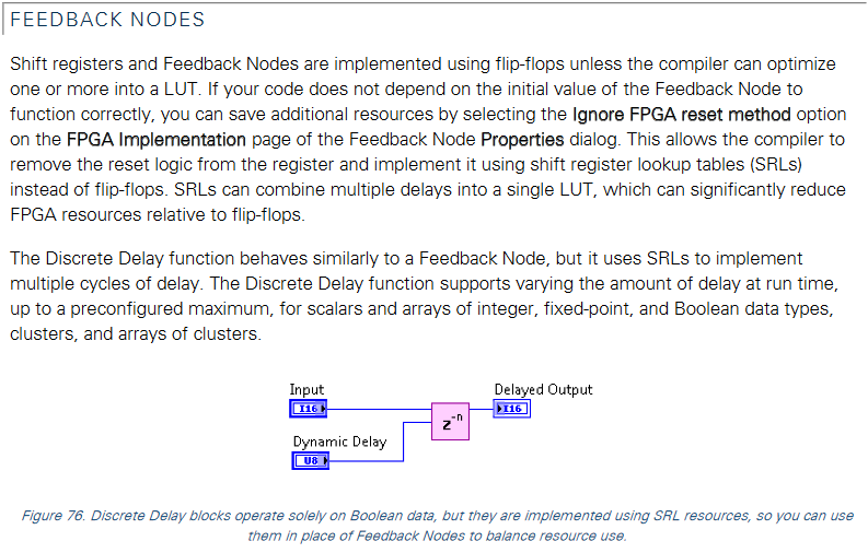

Just a quick follow-up. It's been annoying me that I couldn't remember where I learned of the Feedback node SRL trick. It's in the High Performance FPGA guide. Page 68.
Here's a clip of the part I am referring to. The previous page is also important, but I'm just highlighting the trick here.
This is a gem of a trick!This is a gem of a trick!
