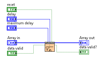

If you're looking for a variable delay buffer the FlexRIO driver installs one. Its used in the default personality FPGA vi for some of our Integrated IO FlexRIO devices, but any FPGA device can use them.
<LabVIEW>\instr.lib\FlexRIO\API\FPGA\v1\Variable Delay.vim
There's also a circular buffer in instr.lib\FlexRIO\API\FPGA\v1\subVIs but it sounds like the variable buffer will get you what you want.

I've not had any issues with IDE responsiveness when using this library.
You won't have access to anything but the oldest element. Its functionally a variable length FIFO. If you need random access you'll need to create a copy of the library and modify it.
When using certain LVFPGA primitives (like feedback nodes) the compiler will sometimes use flip flops, sometimes LUTs, sometimes BRAM. The LVFPGA compiler does a good job of determining what is the optimal resource and instantiates it for you. In this case, if the maximum length of the buffer is of a certain size (I think anything greater than 32 or 64 elements, but don't quote me on that) it will probably use BRAM.
