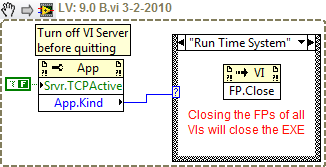

Besides here's a better way to see if your inside an executable:
Ton

Thanks guys.  I used your ideas with a little bit of modification.  I know the name of the VI so I appended it to the application path+application name.  The above diagram is of VI A.
I used TCP port 3363 for executable B and 3364 for my development environment, in case that matters
