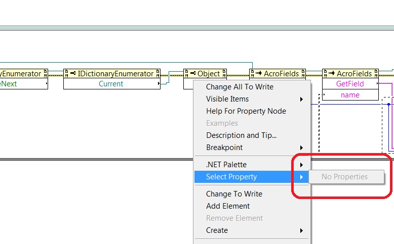

BowenM,
It is the property node key or the invoke node "to string()"?

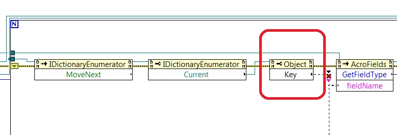

It is the Property node Key there...  it just returns the string name of the AcroField.

I asked the question because I have no property available in "Object"Acrofields.jpg
I will try to solve that next week...
