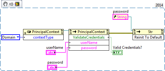

Adding a solution in case anyone comes wandering by later looking.
As far as I can tell it does require a call to the API, but a fairly simple call.
(3,643 Views)
I tried this code for "Machine/PC" and it works well. If  I give correct username and password it gives me "TRUE" output. How to get list of available user in Machine/PC?
