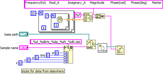

In addition to what Tim just said, you really should try to use less code for all that!
Here's an equivalent code fragment that does exactly the same thing (file name, header and all) with much less effort.

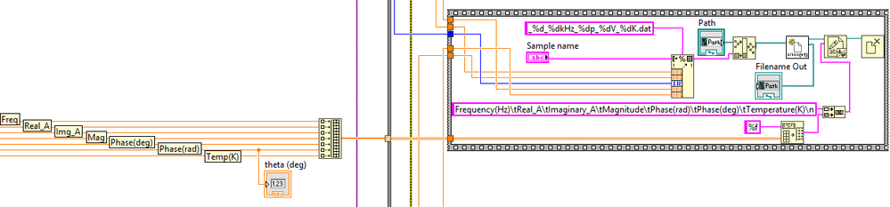

Interesting, I figured this should be an easy task. I actually have tried this before, and it doesn't give me all the same data in columns like it should. I can post the whole code (which I did not write), maybe you would be able to see what is causing this error? Because I have no idea what would be causing this. I'll attach an example of an output I received from this exact VI.
Note: The portion of code you will be looking for is in the top right of the block diagram

Your issue is that Marker value is forcing the Build Array to put everything into a single 1D array, therefore giving you a lot of columns in a single row instead of 7 columns over many rows.  You need to duplicate your marker value to make it match the length of your other arrays.  I would do it this way.
Alternatively, add the marker inside of the FOR loop and that will make things A LOT simpler.
