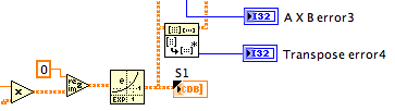

I am trying to convert a matlab code into labview code, after I finished I realized that the output of the exponential is an empty matrix, can any body tell me way please.
The output matrix is S1

Hi, engomar,
The matrix should be square matrix, do you set the M2 properly?

Re/Im To Complex Function
Owning Palette: Complex Functions
Requires: Base Development System
Creates a complex number from two values in rectangular notation.
The dimensions of two matrices that you want to combine must be the same. Otherwise, this function returns an empty complex matrix. The connector pane displays the default data types for this polymorphic function.
The matrix going into the exponential is empty. Fix may be to create a maxtrix of the same size with all zero elements.
Putting indicators on all the error outputs from the matrix VIs and looking at the detailed help files allowed me to find this in a few minutes.
Lynn

If you put an indicator before the exponential and execute the VI you will get result, but after the exponential it give an empty matrix.
