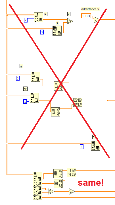

@Rusyaidi_arif_cute wrote:
I only need to get the output to show an off diagonal elements like this,
formula to get off diagonal:
nbr=3
I don't understand your formula, because 2D arrays have two indices, not just one (k).
You have two array constants, which one would you like to process?
Your 2D arrays are not square, so the concept of "diagonal" is poorly defined.
Given the default input, what would be the correct result?
Why would you need to spin that loop millions of times per second doing the same thing over and over?
Are you aware that index array is resizable? Compare these two fragments:

For starters, I did know it was resizable but didn’t know the function for it. Im surprised it could get much more simpler and less blocks than before!
The while loop all over it was just me trying to understand what it does to everything. Forgot to remove it.

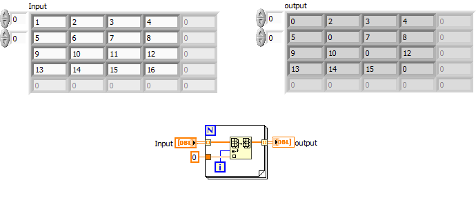

I want to make the diagonal part to be 0.
Maybe like this?
Message 4 of 22
(3,562 Views)
Yes thats how i want to create thank you so much! I will try to do it with my input.
