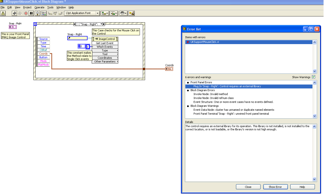

I tried to study the structure, and i can't define how to fix the error and warning of the attached examples.
Why is that happen and what to do for fix it?
Message 7 of 10
(14,538 Views)
Hello suffyzull,
The error codes you are seeing are all related to the Invoke Node inside of the Block Diagram.  It looks like the reference being passed is incorrect.  However, it is important to note that the Invoke Node is not required to get the coordinates.  That was just how I edited the VI and reposted it.  I have attached an update version of the VI that does not include the Invoke note, and still works.
