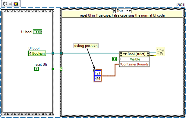

I have made a wrapper case in the main UI VI that is "reset UI" that can be toggled by a bool for dev and debug work. As a dev you can run the 'reset UI" case to put everything back as it should be for debugging.

I was thinking you can make a case and reset where the splitter is so you can see the debug screen. It would be like running "pre-populate" but for dev mode.
