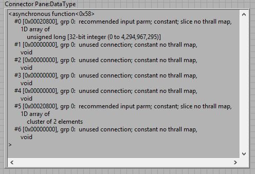

Using the ConPane.DataType returns a variant containing all the data I want, but I do not know how to parse it to get the constituent parts.
From the front panel I can see that index 0 contains an array of U32s and that it's a recommended input. My question is, how do I extract this data?

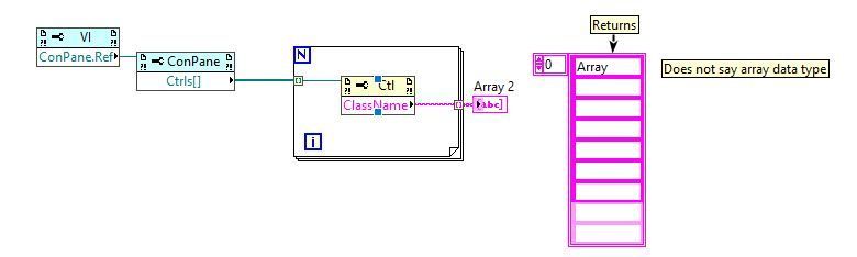

I did try this approach (below) but it strips a lot of the data that I want. Using Get Class.JPG

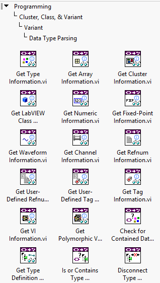

What version of LabVIEW?  LV 2015 (I think) and later have a whole palette devoted to this.

I was playing around with that pallet for a little while as I thought that's where the answer would lie, but I couldn't get anything meaningful out.

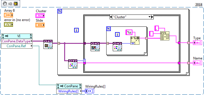

I've uploaded a quick example just to help out anyone else struggling with the same thing. It's no way near exhaustive (for example, I didn't include recursive cluster or array checking).
It's always nice to get to grips with a new pallet set!
