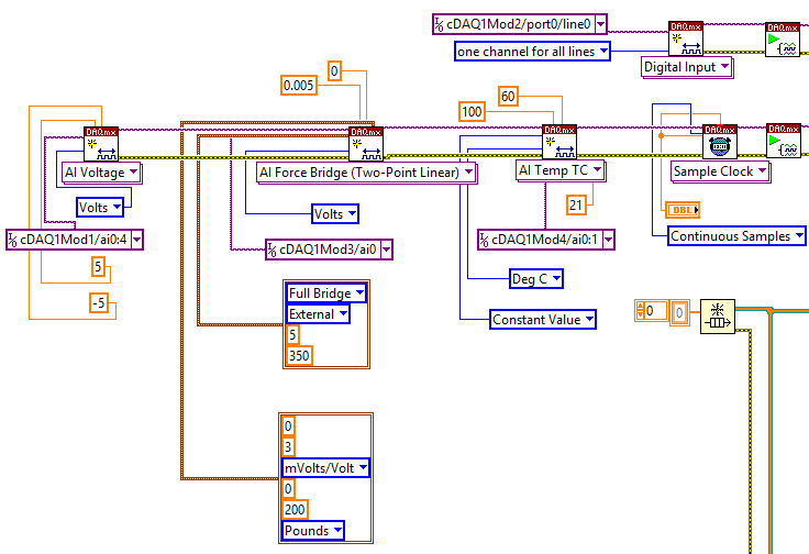

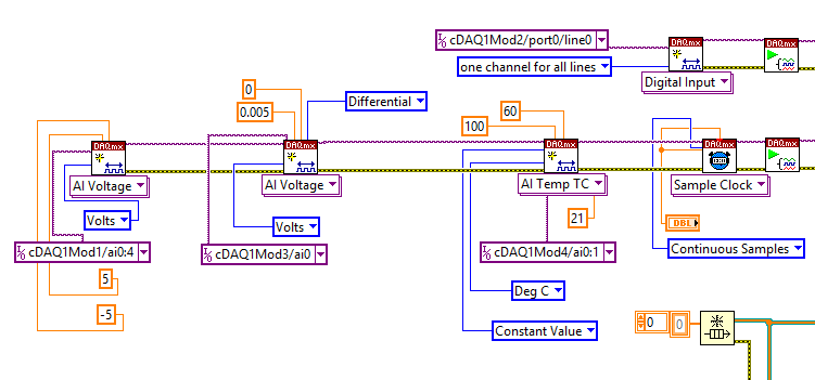

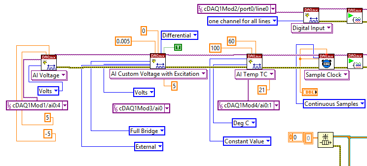

I am using an NI9205 to gather voltage data from a Robot Shop S load cell. The reason I am using a NI9205 is because it’s range goes down to millivolts, making it great for load cells. The issue I am having is when I initialize my task and run the VI, the NI9205 does not output millivolts. Instead it outputs microvolts or even smaller. Loadcells are supposed to output voltage in the millivolt range. I tried multiple methods for initializing the NI9205 and none of them outputted millivolts. The methods I tried are shown below.
The final method I tried gave me an error, which is also listed below.
Any information would be appreciated in trouble shooting this issue!
Error -200431 occurred at DAQmx Create Channel (AI-Force-Bridge-Two-Point-Linear).vi:3350002
Possible reason(s):
Selected physical channel does not support the measurement type required by the virtual channel you are creating.
Create a channel of a measurement type that is supported by the physical channel, or select a physical channel that supports the measurement type.
Property: AI.MeasType
Requested Value: Force:Bridge
Possible Values: Current, Resistance, Strain Gage, Temperature:Built-in Sensor, Temperature:RTD, Temperature:Thermistor, Temperature:Thermocouple, Voltage, More:Voltage:Custom with Excitation
Task Name: _unnamedTask<7F>

Hi KurtzC1,
The NI-9205 module is not recommended for this type of measurement (AI-Force-Bridge-Two-Point-Linear). Here you can find the modules that support that type of measurement: https://www.ni.com/en-us/shop/category/strain-pressure-and-force.html
The error message you get is the LabVIEW way to tell you that what you want the task to measure, does not match the features supported by your hardware channel.
