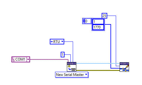

So i am trying to use the modbus library pallete to send the following command to the VFD
Node Address: 01
Function: 10
Starting address: 25 01
# of Registers: 00 02
# of Bytes: 04
Data 1: 00 01
Data 2: 17 70
CRC-16: 60 27
I am confused about what gets sent into the the Modbus write block which calls for "starting address" and "holding register values". If you could advise me on how to input the proper data i would appreciate it.
(7,207 Views)
I'm a bit confused by your VFD product documentation. Normally the inputs for the MODBUS VI's are pretty self explanatory. You'll want to set up LabVIEW as the MODBUS master, ensure you're addressing the correct slave by unit ID, and then you should just be able to specify the address at which you expect to find data. I'm not exactly sure how to read the format in your device manual, but I think your node address will be the unit id input and the first number in the starting address will be the address input. To access the first two registers of data, I think you need to use the Write Multiple Holding Registers.vi and input an array of your two values in the registers input. I've attached an image of what that may look like.
I hope this is helpful!
Austin
Staff Software Engineer
NI
(7,181 Views)
