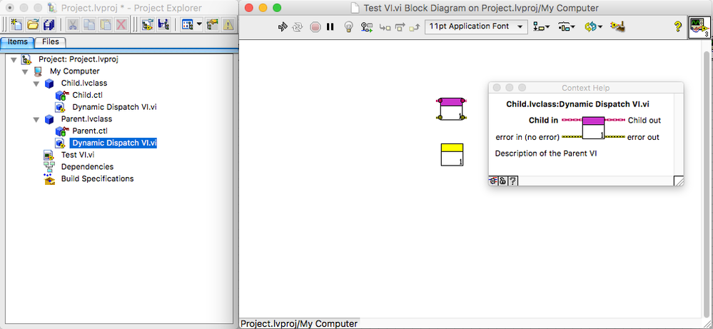

I tested this behavior in LabVIEW 2019 (I do not have 2017 installed in my home machine) and it seems to be working fine:
Child dynamic dispatch method displays parent's description in context help.Child dynamic dispatch method displays parent's description in context help.
Since you didn't attach a reproducing case, or something we could test that showed the behavior, we can't see what could be incorrectly configured. I do attach my project for you to test with.

It works as expected in LV2018 too. But I remember that I had issues with it in 2017, and that it had worked before. Note that when you are in the project explorer, this feature is not active, only when you hover on the block diagram.

My apologies for not including a MWE.  I noticed the issue in a huge project and didn't think to make a small test case.  I've attached a test project in case anyone is interested.
In the attached example, I still don't see the parent's VI description when hovering over the child VI in the project explorer.  But based on thols's suggestion, I tried hovering over the VI in a block diagram and that appears to work.  Is this expected behavior?

Thanks for the insight, thols, and tarheels100. I was missing the part about hovering over the method in the project explorer and not the block diagram.
That's interesting. I assume it's expected behavior, however I do not see it documented anywhere. I opened CAR #745052 for the team to review it.
