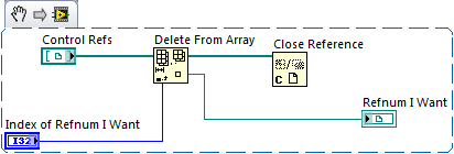

I use Delete from Array frequently with arrays of VI Server references.  It's handy for gaining access to the single reference that I want, and closing all the rest:

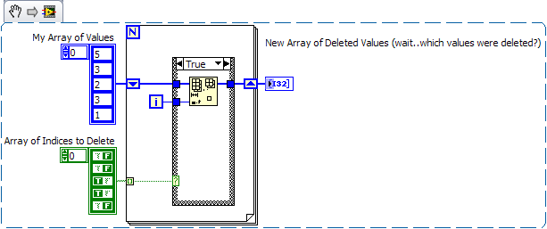

Here is something silly that bit me in the butt recently:
When I saw my error here, it was a pretty dramatic *facepalm* moment.
-nickerbocker
(3,661 Views)
Nickerbocker,
For future reference, if you have a sorted array of indices of items to delete, it will work if you reverse the array of indices, along with the array.  Index-based deletion from the end works way better than from the beginning... 😉
(3,657 Views)
Good idea, Darren.  I can't remember how I ended up solving it (friggen code is on an ext. hard drive that I left at home today, makes for a good Monday...*facepalm* lol).  I will keep that in mind.
