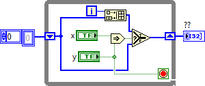

Today it is the "Select" function.  A very common task is to select between two values, and this function does that in a tidy little package.  And unlike the case structure, we can easily see what both choices are on the BD.  What you end up with is clean, easy to understand code, what could possibly be wrong with that?  There is one very important difference between the case structure and the select function, the case structure only evaluates the required case, both cases are evaluated in the Select function.  Usually the difference in negligible, or you are choosing between two values that you have calculated anyway.  However, a common case where there could be a difference is choosing between an array and the same array with a new value added.
The memory allocation for Build Array goes on in every loop regardless of whether or not it is the desired outcome.  In a case structure, only necessary allocations are performed.  Don't ask me what this code does or does not do, it is pretty much random.
One thing I sometimes do, but haven't tested is to have build array in every cycle, but choose to append either the new value built into a single element array or an empty array.  I assume that appending an empty element doesn't force any memory allocations, but I haven't tested it.  I try to stick to case structures now.
Crazy, the array constant is wired to the SR and the node on the while loop, but LV won't show it when I copy.
