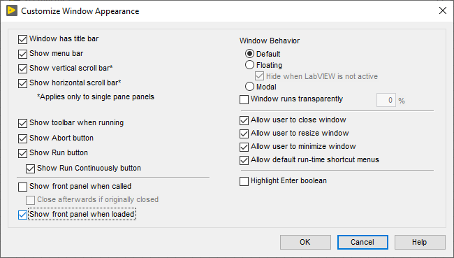

when some VI's in my Project are opened, the Front Panel of another VI (always the same one) also opens. I only want the FP of the VI clicked on in the Project.
Anyone knows why this is and what can be done against it?

Open the VI Properties of the VI that keeps opening and check its Window Appearance tab. I'll bet the Show front panel when loaded option is checked.
Also check the VI node in the caller. You can right-click the subVI node and select SubVI Node Setup... and see the following dialog:
Check for it there too. This is less likely since most people don't even know these options exist.

yep, that did it. thanks to both of you!
