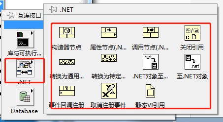

this is one of the error appears after I run a build .exe on XP , while the .exe is build on WIN7.
it tells me that .NET 4.0 is required .
But , I am sure I didnot use any of the .NET node on my diagram , as see below:
I suspect that , some .NET methods or properties are used by LaBVIEW, so even I didnot use  .NET node on my codes , .NET is stilled needed, But I am not sure ....
and then ,what is the real matter of it ?

Hi ali,
this is one of the error appears after I run a build .exe on XP , while the .exe is build on WIN7. it tells me that .NET 4.0 is required .
I guess the LabVIEW RunTimeEngine relies on some .NET functionality and requires a certain .NET version as you create the EXE with Win7. You need to provide the same drivers on your WinXP computer.
Did you create an installer for your executable?
Did you install .NET version 4.0?
