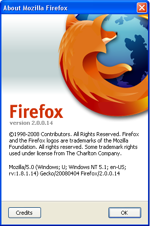

- Downgrade your version of Firefox to around 2.0 (I am not suggesting NI supports this, it is just a personal observation), and you should be able to drag and drop straight into LabVIEW 2009.
Here is the version I used that worked:
Message Edited by macaba on 08-07-2009 05:32 AM
