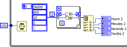

VI starts normally, using an XControl Start button, but when I click the stop button connected to the Loop Condition, nothing happens
I have a very simple app I created to demonstrate a few fundamentals to my students.  I created a really basic While loop that runs on a 100ms display.  I use 4 Quotient and Remainder functions to divide the iteration count by 36,000 / 600 / 10 and 1 respectively in order to create an hours/minutes/seconds/tenths display.  I wanted to show the students how much more elegant you can make an app, simply by adding a Start button, rather than using LabVIEW's Run arrow.
The problem is that, after adding the Start XControl, and placing my loop in a sequence structure and executing that sequence frame via the start button, the loop no longer responds to the Stop button.
I'm sure it's simple, but I'm apparently sleep-deprived.  (That and short-term memory issues ever since November 2015 when I suffered a sudden cardiac arrest while running a Thanksgiving day race)

  • We are missing the x-control, but what's wrong with using the run button?
  • Where did you get the x-control?
  • What would that be "more elegant"? It is not a common sight.
  • Instead use a very simple state machine where the VI is always running, but in an idle state it it is not supposed to be counting
  • All your indicators have the wrong representation
  • The sequence structure is completely unnecessary.
  • The last Q&R seems unnecessary.
  • Teaching simple loops and shift registers to avoid duplicate code is probably more important, see e.g. below. (Of course all this could be done more easily by using tools from the timing palette, but I guess you want to primarily show the integer math here)

4.  The sequence structure WAS completely unnecessary, except that it was necessary given the rest of the application that I removed before posting since I felt it just confused the issue I was seeking help with.  Amazingly enough, when I removed it and connected my evil X-control directly to the while loop, it worked perfectly (so thanks for that).
5.  Man!  You were right about the last Q and R being unnecessary as well!  I probably would have done a better job if I wasn't hopped up on the muscle-relaxers that I have to take when back-spasms bring me to my knees (another reminder of my 11 years beating my body up on three ships).  Connected the Remainder terminal to that tenths indicator and voila!  Works like it should.
6.  And yes, you're right. I chose to do it this way in order to teach the integer math.  Your way is MUCH better and I was reminded of things I'd forgotten having been away from LabVIEW almost completely the last three years.  I just hope you'll continue using the opportunity you have to share your knowledge with others to...share your knowledge with others. I'm not in your class when it comes to LabVIEW development, but then again, I'd be willing to bet I could show you a few things in a wood shop.  And I would't cut your hand off to prove the saw is sharp.  🙂

Incidentally, I realize that I32 is as low as I can go and still get 36,000 Smiley Frustrated

A few quick notes about the points:
  1. Since everything works if we delete the xcontrol, the problem is in the xcontrol, but we cannot troubleshoot that. I am curious: Do you have a link to the video or website? Xcontrols are quite tricky and mistakes are easily possible (For example if its code cannot complete). (LabVIEW NXG does not even have xcontrols, maybe for good reason!) For example, why is the output of the xcontrol wired to anything at all? Maybe it fails to complete, so even if the VI starts up, there is a data dependency, preventing the rest of the code to execute. Again, impossible to troubleshoot without the xcontrol. (but see also point #4)
  2. ..
  3. the iteration terminal is I32 and you cannot change that. If you want to do that calculation in I64, you would need to create your own incrementer in a shift register. The prototypical and most used integer in LabVIEW is I32, so if a terminal is U64, it means somebody must have had a good reason to manually change it. Students take everything at face value and they might get confused about the reason for (1) the red coercion dots and (2) the intentional type change. Of course this can turn into a good discussion topic. 😉
  4. that makes not a lot of sense, but again, I would like to test that with the xcontrol myself and do some research. Maybe there is a bug somewhere that would be nice to expose.
  5. OTOH, if you use a FOR loop like I did, that last Q&R operation is back in. Can't win. 😉
