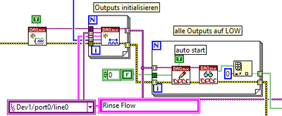

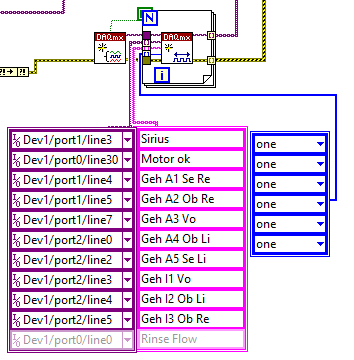

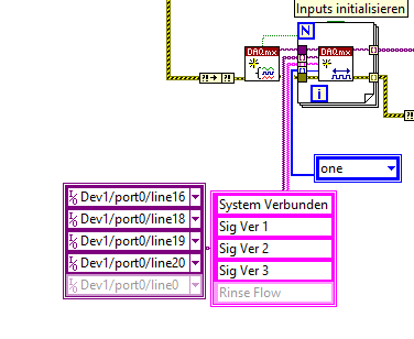

ok, from the first smaller screenshot that might be confusing, so here the explanation:
part one are the outputs, (valve settings, etc):
(for better handling i keep an Boolean array with the status of each Output)
part two are the "non critical" input signals:
part three are the critical Inputs,
so i store them in the Cluster:
main reason is the security handling:
additional to the three Loops of the QMH I created a fourth on, which only handles security issues (like open housing, emergeny button,..)="Task Sec"
for handling those Inputs  in another loop I had to create this in another "section" as accessing from two loops in the same task array does not work.

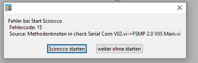

the I/O's does work, as after initialization I check some of those and thereby I get no Error, so this works
when I try using the Serial communication I get this one:
Message 16 of 17
(905 Views)

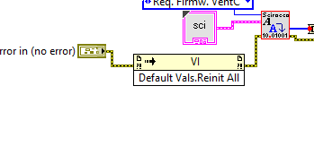

ok, got the source for this one:
it was the invoke note at the beginning from the VI.
after deleting I don't get the error any more
and very curious:
now the VI and the serial communication works
now I'm confused
